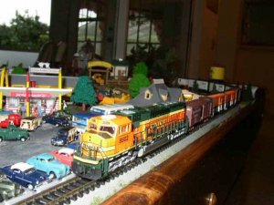

I received my first Kato SD70 Mac BNSF HII a few days ago and so far I have not had a problem with the stock coupler and any of the MT's on my rolling stock. What is the main reason to change the coupler to a MT ?, should I expect a problem with the stock coupler ?
Andrew
