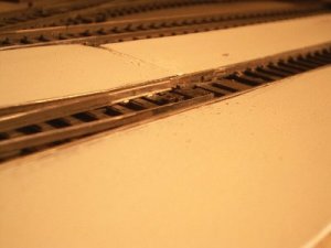

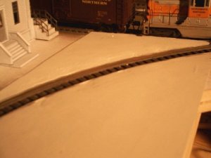

I'll post some photos of my latest adventure, albeit incomplete, in street track...as you can see, I haven't done the in-the-middle trackage yet, but you can see the outside edges. It has been painted with Woodland Scenics Street System Concrete--it looks a little bright now, but I'll add some goo and grime once I get the middle section in place.

One "plus" of the styrene method is that, unlike plaster, you can go back and fix trackwork later. An important thing is to try to get the level of the styrene slightly below the level of the track, to make track cleaning less daunting.
