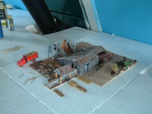

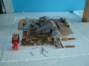

I have some pic's of an old turndown mill I used to work in thirty years ago, I'll get D to post 'em . It's not the actuall mill, it burned down years ago but I have enough of it scratched to meby be usefull ( although it's just a little backwoods NS mill not a biiiiig BC mill ha)

How much of that is a kit and how much scrath or kit bashed?
The more I look at it the more I see.
You could sell those and do very weel.
Relic
Nov 6, 2005
366
73
Nova Scotia
I've been tinkering with this for a while, scratched from the first non-steam mill arround here, actually the mill is the same it just has a jimmy deisel instead of a boiler.
The model is as you can see not finished it still needs more deal piles and a few log brows, although in thors days they tried to dump the logs right on the skidway.
I could go on (and on) if you want more info it's better (and shorter )if you ask.

What is the structure on the left?
Is that a way to feed the logs in the mill?
If so how did that work, with a crane or fork lift?
Relic
Nov 6, 2005
366
73
Nova Scotia
Gil
No, that thing on the left just behind the truck is the wood chute, slabs were cut into about 16" lengths and sold for stove wood (that bashed Ford is a slab truck)The thing kinda above the wood chute is the sawdust chute, a long chain with wooden buckets dragged the sawdust outside.
You can sorta make out at the top right(I'm a lousy photographer) the skidway where the logs were unloaded and rolled by hand to the carrage
A very interesting place to work, nearly everything was run by leather belts, everything was open and the noise had to be experienced.
The scary thing is after it burned down it was rebuilt nearly the same only with an edger witch made more work for the splitterman and nearly doubled production(to 11 thousand board feet per day)
