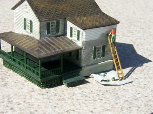

Problem solved
I figured a way around having to paint the details on this building. As you can see, I hired a guy that was small enought to get close in and do the details. We decided that as long as he was there, he should just go ahead a paint the whole house. As you can see, he's already started.:D :D :D :D There is a bucket of paint on the tarp, but it's hard to see. I still have a ways to go with my camera work.:rolleyes:
Don
