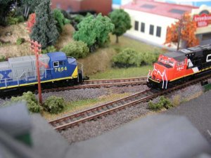

Well here's my two cents too and I won't repeat what was already written...I've bought Bachmann Spectrum line (Dash-8's mostly) and they run well. Yes more loudly than an Atlas or Kato, but the detailing is quite good for the money spent. The EZ track can be ballasted and weathered and looks pretty good when it's fixed up right (IMHO). Here's a picture of my Bachmann Spectrum Dash 8 pointing at an Athearn SD75i...the dash-8 has pretty good detail and coloring. (I just put on microtrain knuckle couplers on the Dash-8 removing all traces of the rapido coupler - so it looks even better.) The track is EZ track that I ballasted (first attempt) and weathered (also my first attempt at it). I'm also weathering the Bachmann diesels and they look pretty good with a little dirt here and there. All in all, you can find some good deals on just about everything - Bachmann included - and at a discount, the Spectrum line shouldn't be ruled out when you want to add to your engine/rolling stock because of an old reputation.
