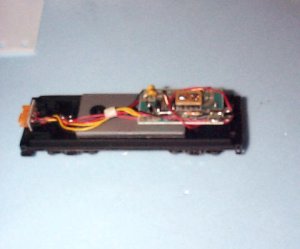

I opened up the tender of my Backman Spectrum Consolidation awhile ago to see about putting ina decoder and discovered this. What is it? Does it appear to be a decoder? I'm not smart about these things, or much of anything else actually:D :D

You just prompted me to have a look inside mine. It is a full wave rectifier with two high frequency filters. the small "box" with a circuit board on to is an 8 pin dual in-line socket and the circuit board is just jumper connectors to let the loco run without DCC. I presume the circuit board gets replaced by a DCC decoder.

Thanks very much Errol, I knew that was going to be too good to be true to have a decoder already installed. That would be just like the decoder I bought to put in it (DH142) doesn't have anything but the bare wires to mate to the socket. I'll need to regroup and see how I manage to get that all hooked up without destroying it:D :D

Bob, What you need to avoid soldering in this case is the decoder DH142P, which includes the 8 pin plug, as opposed to the DH142, which has loose wires. The replacement harness assy is available from Digitrax dealers for about $4.00.
