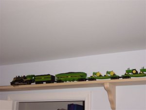

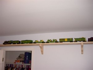

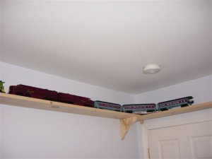

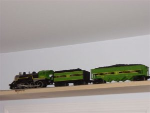

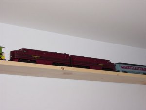

Hello every one I'm new here and just wanted to post some pic's of my weekend project I put some track around my son's bedroom so that the trains are out of the way and not on the floor i'm using mth's dcs to run the trains he has two up there now one steam and one diesel the diesel is pulling his polar express cars for now let me know what you think still have to take it down and stain it thanks i will post more pictures after i stain it

My seuggestion is that you put a triangle of wood inside the corners so that there is a bit more track support and something to catch anything that derails. A 6"x6" triangle might be enough. When it derails, the train will often come off the inside of the curve; a bit of fence might be a good idea.

It's 1x8's and I think when I take it down to stan it I will put up some railing something like a cattle fence

One word of advice..It seems you have a good stretch of unsupported shelf. What seems apparently "solid" wood will start to sag, even under its own weight. Shelving like you have should have supports at least every 24". You don't want your trains "see-sawing" their way around the room.

Supports every 16" or 32" will match the spacing of the studs in the wall...

it is o-31 gauge it might not look it on the pictures but the supports are about every 2 to 3 feet and i needed to work around windows and doors I'm also thinking about puting wood blocks to fill in the space from the top of the doors and windows to the shelf thanks for your suggestions they are very helpful
