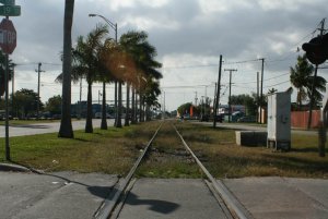

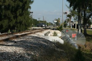

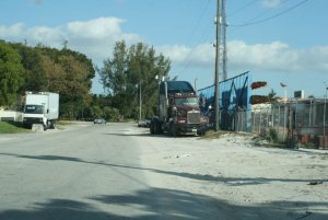

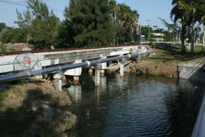

One thing I might consider adding to the module is working in some water - canals run everywhere in Miami. As for soil color, the makeup of the local geology is basically coral and lime rock, and there's a lot of powdery white sand around. I'll snap a few pics & upload them.

Here are a few pics I snapped this morning, that you may find helpful - unfortunately, no trains out. :rolleyes:

Colton, thank you very much for your help :thumb:. The pictures show that I am on the right track with the materials I already have. I only need some very fine, light gray sand to tune down the white sand I have, but then I think I will be ready to start.
