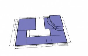

  3. RonP
    RonP Member of the WMRC
    Nov 3, 2006
    640
    ok the benchwork is finished and looks alot like this pic i've added i was hoping to get some opinions on track layout from those who care i want logging a raised area and mainline op. mostly based on steam with one or two diesel switchers. I'm not crazy on prototyping exactly either.
    only differance in the pic and layout is the 8 foot side turned out to be 12 foot
  4. ocalicreek
    ocalicreek Member
    May 4, 2005
    838
    Looks like you've got some tight turns there. What's your minimum radius (or did I miss that in previous posts)?
  5. RonP
    Nov 3, 2006
    640
    Minimum turns , I bought a box O track from a guy here on the gauge, It all consists of sectional track. Having said that i intend to buy some flex track to acomplish what i need to accomplish.
    I was talking to the wife and it is possible to close in the the horseshoe. Since it is you who replied i will make a better detailed design of the benchwork right now as i made the benchwork a little differant from the picture. I recently moved from window$ to Linux so ii am still learning how to use the free apps please bear with me.

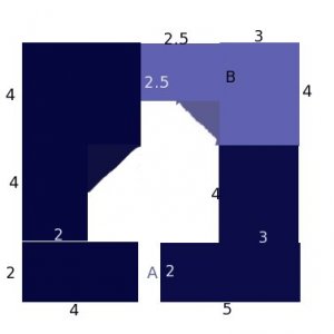

  6. RonP
    Nov 3, 2006
    640
    Ok i made a crude design with gimp ( i will need more exp with it definatly) but here is the layout as it stands the dark blue is built the light blue is still being thought out. One note that is important the 4X4 section was hell to get up in the aTTIC SO NO MORE 4x4 will be built and that one should be cut down to 2- 2x4 sections.
    It is also built to be taken apart as i rent ATM.
    So it is 10 feet by 9'6" the gap is 6" and is made so i can put bridges over it. I have no intention of covering it in till i buy a house. That means it could grow for a large bridge when i move next year or so.
    Oh yeah and the 2.5 foot section could be a tip up or duck under.
    The track work i have can be redone i pulled it all off and left the road bed as i need to clean all the track and take out the brass sections ( i have Nickel silver track as well and will use that for mainline). section marked A is a 3% grade slope starting at the turnout.

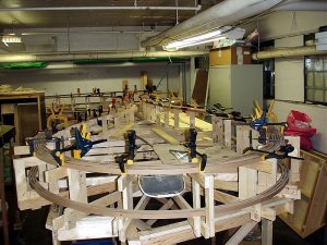

  17. RonP
    Nov 3, 2006
    640
    Well lately i joined the local Model Rail Club and it has been a great experience. Here is a pic for anyone interested i helped by putting in some of the riser sections here. I joined the club as they are moving from modular to a permanent NEW layout and im getting in on the ground floor so to speak. I think i might start a progress thread for this as well once im settled into the clubs ranks.
  18. Ralph
    Ralph Remember...it's for fun!
    5,347
    Interesting pic! How do you like that spline roadbed technique?
    Ralph
  19. RonP
    Nov 3, 2006
    640
    My observations on the spline is masonite is very easy to cut and it is easy on the saw blades. It is messy to sand but sands very nicely with a power sander.
    The grade changes are ULTRA smooth due to the process of long spline component lengths.
    When the glue is dried it is a very solid system and is by comparison allot easier to use then other materials i have seen.
    All the problems the guys have at the club are problems i am very willing to work with which are cutting a sheet on a table saw is ackward (i am very versed in ackward carpentry)

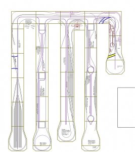

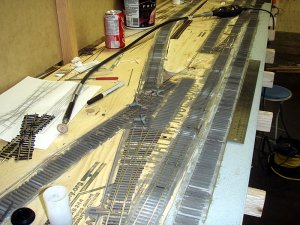

  20. RonP
    Nov 3, 2006
    640
    Tonight i am going to look over the guys doing the hand laying track with the Fast Track system. Below isd the club (not finalized) layout plan.
