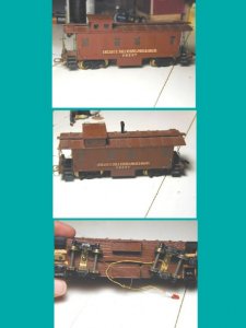

Heres Dads old caboose.....some parts missing and dig that ancient coupler on the 'back'.
Question #1.... does the raised part of the roof go towards the front or back of the train?
Questions #2..... I think the trucks are meant to power a light that goes into the hole in the bottom of the caboose..BUT I've hooked up a light a number of different ways and the light works but the trucks generate sparks, which gives some light but ..lol
OK heres Q2...how do I hook up the wires properly??

The raised part of the roof, the cupola, go towards the back of the train.
The wiring to the trucks are correct. Clean the wheels and that should help with the sparks.
Marty

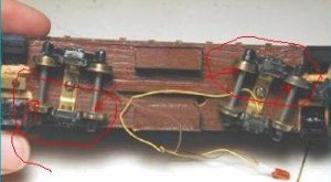

aartwmich,
I thought of another, check to see that the wheels are insulated. The red arrows show where a plastic washer should be. This washer should be between the axle and the wheel at all 4 locations.
Marty

First I'd like to thank you for posting you caboose. Now I'll see if I can help with the Questions.
1) The Rock Island ran their caboose's with the cupola towards the rear. This would put the brake wheel as the front of the caboose. The RI ran them this way since 1903 so that'll cover your steam engine (can we see that up close too???please please??) They even had rear view mirrors on the left side of the cupola.
2) Like Marty said, cleaning up the wheels should help with the spark's, cleaning the track also will help. If that doesn't work make sure that the wheel sets are installed properly, One of the wheels will have a plastic or rubber insulater on it, they need to be on the same side on one truck and the oppisite side for the other truck so you have a possitive truck and a negitive truck so to speak.

OK Thanks guys for your responses..I guess it doesn't matter which way the cupola goes, I had read somewhere that it should be forward but that might have been a road specific thing. We are not road specific here at my house...just playing with trains!
As to the trucks..the wheels and axles are one piece so it appeared that there was no place for a washer between them. Then I noticed that where the axle (must be) pressed into the wheel was a dark ring between the axle and wheel on one end of each wheel set... AND I saw that I had switched one of them around when reassembling it after it had fallen apart on a run (that was funny). SOOO I've got the wheel sets on right now and NO sparks and damn that light works ALOT better now...LOL
Thanks for your help, it's always easy once you know how!! ;)

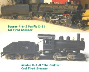

and here's my engines..not sure which one RI541 wanted to see

I like them steamers, not sure which one I like the best,
Lately I've been absessing about steam engines. I don't know why. I love diesel. I hope this is a passing thing. Maybe it's a good thing. I need counseling.:( :) :D :D :D
Thanks for the Pictures

If you don't have the rear set of wheels for your 4-6-2 steamer, Bowser is still in business. You might be able to pick up a replacement set from them. Nice to see those steamers still out there doing what they were designed for, running trains.

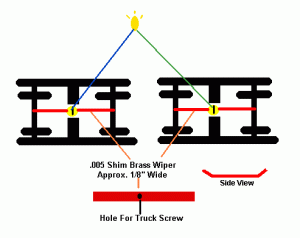

Hi and glad you got the sparking problem squared away. Here's how you can get rid of most of the bulb flicker when the caboose is moving. Add a set of axle wipers made from .005 brass shim stock. This will cause the trucks to have a more positve electrical contact.

Vic, I got the same suggestion from my LHS for my bluebox passenger cars. He suggested using the copper from a broken flashlight. It is a good width for HO and is pretty cheap (who doesn't have a few of these floating around?). Plus, you don't have to cut copper strips.... ;)

Hi Micheal, The flashlight idea is a good one:) Even if you don't have a broken one laying around you can get a Made In China plastic one for a buck and end up with more copper or nickle silver strip than you can get at the LHS for $1.00:) Some of them have some kind of tin strip that would work ok.
