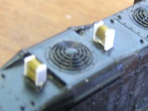

    Nice modeling Tad. The spark arrester/stack is available from Details West. What are the grills on your model?

    Details West offers them in HO, unfortunately I model in N.
    2slim has offered me a drawing of them, so I guess I will have to figure out how to make them.
    The grills are from a Gold Medal Models #160-40 detailing set.

    Spark arrestor scratch pic
    I think Tad & I have the spark arrestor nailed, I needed a couple as well, so I got some Evergreen I beam stock, (P/N 274) and a little brass screen and here's what I came up with. They are 1/8" tall and use the cast in base, just wrapped the screen up over the top of the I beam section and glued em in place.
    2slim

    Now that finals are over I have been able to get back to some other things.
    After talking with Todd on email about how to try to make these spark arresters, this is what I came up with.
    I used Evergreen .125" I - beam cut to .100" for the body of the spark arresters.
    I used some Evergreen .010" strip to cut the base plates from.
    [​IMG]
    These are the I - Beams assembled to the baseplates with Testor's Model Cement.
    [​IMG]
    A finished spark arrester.
    [​IMG]
    I cut a .010" thick piece from a .030" x .030" piece of styrene to make the ears that the MoPac version of these spark arresters have. They don't show up that well in this shot.
    And now that we have done all of this I found out that JnJ makes a similar spark arrester.
    [​IMG]
    It would still have to be modified a little to be like the MoPac versions.
