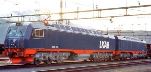

If you count double units as one locomotive, I think that the IORE is the most powerful at the moment. Each of the units has 7200 hp, a total of 14400!
The engines run on the North Swedish iron ore lines Kiruna - Narvik and Kiruna - Lulea. They are really impressive beasts, as you see below.
Ron

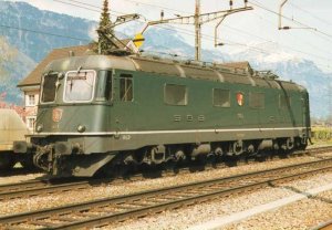

BUT...
As it seems, at the moment we have the most powerful electric loco (single units!) here in Switzerland. The funny thing is, that these 'Re 6/6' engines are already almost oldtimers! They were built 1972-1980, but they are still going strong, pulling freight and heavy passenger trains across the Alpine lines (Gotthard and Simplon line).
With 10600hp they are the most powerful electric engines I have found so far. :thumb:
S3/6, you mentioned the German BR 182, also called the 'Taurus'. Beautiful locos, but they have 'only' 9500hp and are still topped by another Swiss engine, the Re 465 of the 'Berne Lötschberg Simplon' line (9520 hp). :D
Ron
