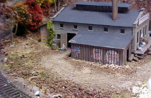

Now that I've giotten the Marksberry Feed Co. in its new home on the layout, I'm doing some of the surrounding scenery...I wanted to depict a dirt track running from the main road, around to the rear prtion of the structure...
I use sifted dirt for ground cover, but since I model in N scale, it tends to be rather coarse...not very well suited for a dirt road as is...
(the white area is where another structure will be)

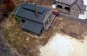

I had read about this technique several years ago in MR, but had never tried it...
I bonded the sifted dirt with 50/50 white glue & water, & waited until it had dried thoroughly for 24 hrs...then I took a small piece of sand paper, & simply sanded a path into the dirt...

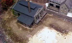

I think this worked pretty well...
Here's a view from a lower angle...

Thanks for the tip Charlie, good show. I to was wondering how to do that for N scale, I have used sandpaper for the lanes and then chalked the h--- out of it. Not bad, but yours looks great. I will try it. :thumb: :thumb: :thumb: :wave:

If the dirt is thick enough you could run an N scale truck over it wikk just enough pressure to leave tracks.Once the dirt is dry you sand it and end looking like Charlie's great work but with tire tracks .

Charlie that looks great,the addition of tire ruts would just add another demention of detail. I been fooling around with sanded grout for my dirt and found a color that I like alot and am wondering how you got yours down in such a nice even fashion? I sprinkled mine with a small spoon and then wet the area, a little trowel work and viola'.The tire tracks are going to be the next challenge for me maybe a small piece of wood sanded with a notch spread far enough apart and then use it like sand paper.I'd love some other opinions and /or idea's.Pat

I have a "dirt" road I made from sifted sawdust. It does appear a bit corse for N scale so I tried your idea on a part of it. What an improvement. It looks so much more to scale and more natural.
Your new grandson has a good teacher and role model. Thanks.
