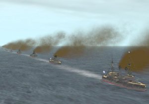

I mentioned this in another pre-dreadnought thread, I am going to take the liberty to do so again in case any pre-dreadnought fans out there haven't heard about this.
About a year ago an excellent pc game came out covering the Russo-Japanese War, "Distant Guns" by Storm Eagle Studios. The game is exceptionally detailed, the campaign game in particular is outstanding. Anyone who likes naval sims, pre-dreadnoughts or the Russo-Japanese war might want to check this game out.
The developer just this week announced their follow-on game, "Jutland". They tripled the polygon count on the ships, so they look even more stunning.
Below I'll post a (cropped) Distant Guns screenshot.
BTW, I have no connection with this company or game. I just like pre-dreadnoughts. :)
Steve, sorry to post OT in your thread. Looking forward to following your build!
