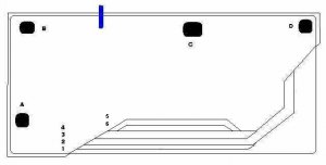

Ok here's one way: :D :D :D (See Crude Drawing Below) :D :D
Here is a really simple loop with a 2 track main.
Towns A B C & D
Yard Tracks 1 & 2 Right (West Bound)
Yard Tracks 3 & 4 Left (East Bound)
If a train comes into 1 From Left with cars bound for C or D you are ok.
If a train comes into 1 From Left with cars bound for A or B - You have to switch them around, or run past the "Invisible" Half way point. (Blue Line)
Yes the cars will eventualy get to A or B - but in real life that Blue line is a break signifying the end of the line. If you cant pick up a train in Boston & Move it to Florida to start over - You CANT do it here LOL (The Reality Police don't like That) :D :D :D
Now, how do you do that???? You need a switcher engine at the track at "6" ( "5" is your MOW / Caboose track). You bring the switcher either direction & build the trains for any Single town or any 2 towns either Westbound or Eastbound. The direction of the engine has to be correct as well as the caboose should be there if you use them. :) And finally the newly constructed train heads lets say "Right" on the Outer track. It drops off cars at D then maybe picks up some, then proceeds to C - When it finishes at C - it becomes an "Inbound train" as soon as it crosses the Blue Divider. This can be anywhere on the layout you want it. Just "mark it" with a building or structure. As soon as the train crosses that line it's "owned" by "B".
You switch some cars at "B" then go to "A" then into the yard.
Also somewhere you should have at least One Car dedicated to MOW or Derailments. If a train derails or a switch fails you can't touch it - untill you bring "the Crew" to the site. If Engineers & Brakeman cant rerail a boxcar - Then you can't either.
You can make this as real as you want to - That's the great side of this Hobby. Run in circles, Drop off random cars - or go "full reality" with waybills, and call names for each train. :) :D :)
Also - If you have Passenger Trains - whenever a train crosses the "Blue Line" they should be empty - otherwise all Passenger trains run from C... past the yards to B..... & then reverse direction back to C.
Some people I know that run HO, actually make it mandatory to obey Grade crossing signals (Sound System Horns) They obey "reduced speeds" when necessary & use helper engines for steep grades (even though one engine would have no trouble)

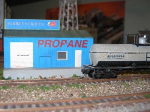

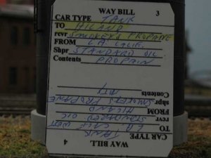

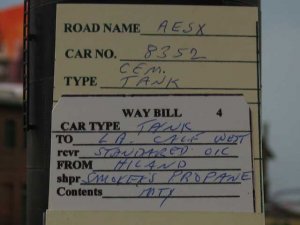

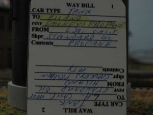

Ok heres the pictures i promised
#1 Smokeys Propane and the Tank car
#2 The Car Card with the waybill in the pocket
#3 The waybill on one side
#4 The other side of the waybill
I took it after everyone left the Christmas party.
