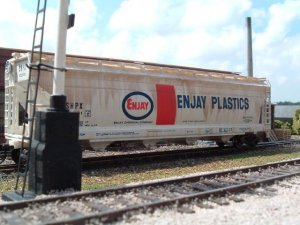

You'll probably be able to change out the wheelsets rather than replace the trucks. On this hopper I used Kadee 33" frieght car wheels as they were a drop in fit. Kadees are my favorites followed by JayBee and Intermountain. I'm betting your draft gear boxes will take Kadee #5 couplers with no problem.
It would be best just to carefully sand it off. More than likely a solvent type glue was used and that would permanently scar the plastic. Lettering can usually be removed with Microset decal solution.
I do most all my weathering with pastels and water soluable acrylics sealed down with Krylon Matte Clear (5x the paint for half the price). Practice and patience are the key.
