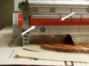

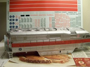

    I use Micro-Sol exclusively!
    I usually apply it after the decal has set for awhile.
    This picture shows my F59PHI I'm working on, with the decal set I'm using in the back.
    You can see where the Micro-Sol, snuggled down the stripe into the corrugations.

    After checking out the pics I took for this thread, I noticed that I still have some air bubbles.
    Poking these with an X-Acto blade and reappling Micro-Sol will take care of these.
    I even apply Micro-Sol to decals that are on a flat surface. This helps keep the decal in palce.
