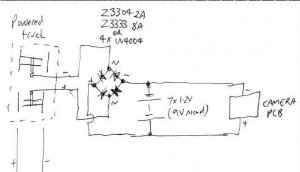

just remember-powered truck-bridge rectifier(gives you 1.2v drop across it)-true 9v nicad(7 x 1.2v cells)-camera
wish geocities still let you link :-( id draw a quick schematic
the old board i could upload a pic from my hdd-doesnt seem to be an option anymore???

hey can still do it :thumb:
edit-put a switch between the battery and the camera btw-saves running the battery flat when there is no power to track

I would still put a 50 cent LM7809 between the battery and camera, but you guys do as you wish. It's your magic smoke. :) FRED

Thanks, Boppa, I'll be experimenting with that setup. I'd love to eventually market a ready-to-run loco with the camera and sound already installed with a price aimed at everyday working folks. I don't plan on making a living at it but I do love seeing little kids faces when their little noggins realize that the train they're watching is the one they're looking out of on TV. Just too cool.
