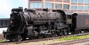

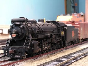

Today's mail contained the long-anticipated CN number plates for under the headlamp of the BLI Light Mikado I'm converting over to CN, so the project was suddenly a go again.
Previously I'd put in a feedwater heater bundle, water pump and some piping, and decalled the tender. The CN SIG that arranged for the number plates also has brass cab side numbers, so I used those as well.
I should say a little more about the brass number plates. Every single number from CN's all-time roster has been made out of photo-etched brass and they're totally amazing!! You paint with an appropriate red paint, and then lightly go over with a fine abrasive, like crocus cloth, and all the details just pop out!
