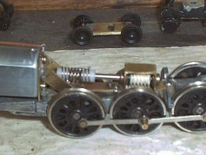

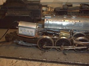

I have been doing it the hard way. (The cheaper route)

Hey ray, thats sweet and exactly what i was looking for. as mentioned i put one HH in a 2-8-4 and i cant say that its that great. tops speed is only about 35-40mph at 12 v, which is fine for freight, but i fear that this is much too slow for a passenger hotshot like the pacific. that and it bwas a pain to get running properly (its an older model, the website has new seating for the moror whuich would probably be better than what i have). What kind of gearbox you have there? aside, i have so many can motors i cant justify not using them for every re-motor. i look forward to your reply. im not worried about burning them out as they have been used on old bowsers with decent results.

The gearboxes are both built from scratch using the original gears.
Mantua did sell a retrofit drive kit. I can't remember the part number, I saw one on Ebay a few weeks ago.
I have installed NWSL gearboxes in a few also. It isn't to hard but you get into pulling wheels and gears off the axle which can sometimes be a pain. Not the cheapest way to go either.

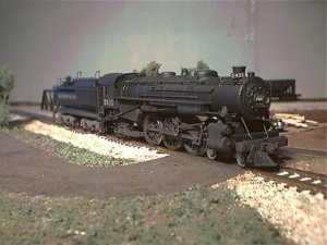

Well I haven't even started on the engine yet. I'm just working on the parts list for it. So far I want the helix humper, a vestibule cab and an elesco feedwater heater but I'm sure the list will grow as I look more into it.
This is what it looks like now:

wasnt tne CN pacific of the closed cab type? i know that precision used to make both plastic and brass closed cabs for this model, and they were (i think, or maybe Burlington) a CN prototype. in any case, thanks for all the info. the second shot or rays mantua has inspired me to make a similar setup. like the spring as a flecible coupling. beats neopren.

The spring coupling works out well. I saw it used in some N scale Life/Like locomotives.
I used the bearings from an old Mantua motor in the gearbox.
I found a set of Bowser pillow blocks used in their big boy, mountains and pacifics.
I was thinking they may be able to be used on the Mantua/Tyco frame to hold the worm and shaft with some modification.

The Canadian railroads had the vestibule (closed) cabs that's one of the items on my list for this loco. Precision is probably what I'll go with considering other closed cabs are two or three times it's price.

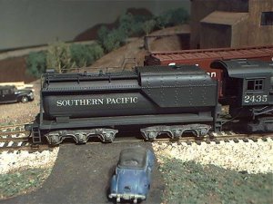

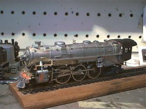

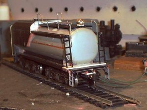

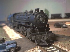

I just finished this one.
Here's a few photos.
The tender is bashed from a wrecked Tyco tender and an AHM tank car.
