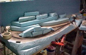

Hi Velmo!
I can show you a couple of pictures of what I've been doing recently... (a portable N scale layout)
I like to stack styrofoam into rough shapes that I carve down to what I want, with a small hand saw, & a wood rasp...
Here's what it starts out looking like...

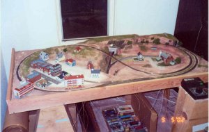

After I've carved the foam, I use a product called Sculptamold, to smooth out some areas, & fill gaps...
I then paint the surface with earth-colored latex paint, & sprinkle on real dirt that I've sifted through a metal window screen...
(I cover the track with masking tape during this process)

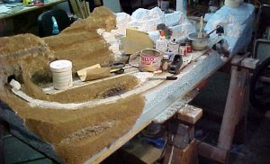

I have found plaster cloth to be very easy to work with, if a bit pricey. You can buy plaster cloth in varying widths from medical supply centers for a reasonable price. Dip in water, lay over the base forms, smooth, paint. Real easy-like. Looks like this:
