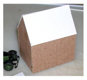

    I want to try building a Maine style house and store using some of the newer printed papers that represent wood. I placed an order with Clever but needed to start something right away so decided on this freelanced Maine style garage. I've posted the hand drawn plans / sketch in the new blueprint forum section. I started with a cardboard mockup to help visualize the size and shape. I liked the steep pitch and the short overhangs. Construction is sheet and strip styrene, balsa, paper and commercial shingles with cast details and twigs cut for fire wood.

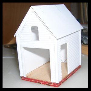

    28
    This is the basic construction with openings for a commercial side entry door and a scratched front garage door. The window above the front door will be for the small storage area. The opening sized for a small caboose window salvaged from an old Urlich kit that didn't sell on Ebay and was cut up for parts. The foundation is balsa wood painted to resemble concrete with a brick border.

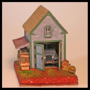

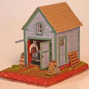

    And the completed garage. I finished with an I&A wash, green trim, overhang addition for wood and a jeep inside. The base is styrofoam packing glued to cardboard with WS ground cover and small details. Now to place it on the module. Thanks for looking at this Maine style garage.

    That looks really nice! Really impressed with how you made it come to life and how you made it looked used and useful. Thanks for sharing. Excited to see the module scene that you are adding this to.
