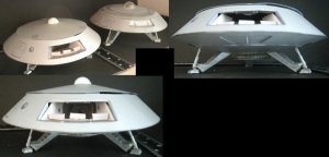

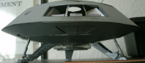

GEDC2270.JPGStill working on it, have to glue the viewport to the control area,
and also the struts for the window panes.
Then figure out a viewport ledge piece for the bottom front,
of course all 3 legs. its about 5-6 inches wide.
[ On the bottom hull viewport, I cut a piece and folded it,
so it would appear to have a seam,
cut out the area on the hull and glued in the folded shutter. ]
Just going to have a simple yellow blinker in the dome and power core.
Thanks for being patient.

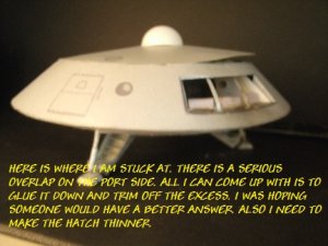

the hardest part is going to be connecting the roof to the upper hull. I think I can manage the viewport bottom sill piece.

Spaceagent,
Hmmm... I'm thinking that maybe you should have joined the top to the sides and then attached to the bottom. Of course that's not going to work now without scrapping the model.
Ok try this - Glue internal tabs at about 1 inch intervals around the internal periphery of the side walls along the top.
Bend the tabs so that they are slightly bent down with the top side walls, but elevated enough to make a contact with the top. Also, maybe reinforce the tabs with wire twist ties like the ones that are used for bread make it harder for the tabs to deform when applying the top.
Apply glue on top of the tabs (the portion that is facing up towards the top of the model).
Then apply the top of the ship on top of the glue tabs.
When dry, cut the periphery of the top so that it is flush with the side walls.
That's all I've got for now.

that's exactly what I did in a fashion! what I am having trouble with this model is , that the hull ovates in the aft section. and the ceiling isn't just a round peg fitting into a round hole. I might have to make and ''underlip'' and just hope that the gaps aren't too much. snipping it to fit. I don't know why I get this ovation in the back of the hulls. I might have to print out my own and cut them to figure out whats happening.

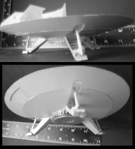

I am still having a real problem with the roof hull plate. I guess I just need to pop the connecting seam on it and lay it in and trim to fit. sounds easy, but im sure it wont be and I hope I don't ruin the job I've done so far.
also trying to figure out the steps on the landing gear. gluing in plates is really a hassle. folding typing paper and gluing in the folded plates with the spaces between them glued to the inside of the landing gear leg might be the answer.
