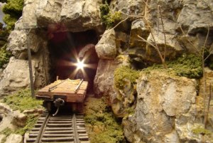

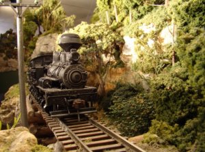

    Classic Train in a tunnel shot.
    Now its time to leave the fast paced world of the trains in Caseyville and get back out in the rustic wilds of the C&S RR. In other words its back to pure logging RR action on the C&S mainline as we travel further East.
    Our energetic photographer got through the tunnel at the "Three Bridges" site just in time to shoot the classic "light at the end of the tunnel" picture of a Shay shoving a flat out of the tunnel. Later on a three trucker Shay was making its way up grade (2% ruling grade on the mailine) and it too was captured for posterity just outside the tunnel.
    Doc Tom:mrgreen:

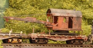

    The rails on the flat car are for the barnhart log loader. Here is an eplanation taken from the Steam in the Woods website:
    "The Barnhart loaders rode on either permanently affixed, or temporary tracks on top of the flatcars or log cars. Where permanent tracks were used, the rails were laid only the length of the car bed, so as to prevent binding in sharp curves; the loader moved across/between cars via the use of of a transfer rail, or a "shoe fly" (an inverted "U" shaped piece of steel), placed across the space between cars. Temporary tracks where used, were built in three equal sections; where the loader rested on one, the second spanned the gap between cars, and the third sat on the following empty car. As the loader proceeded down the train, it moved to the piece on the following car, then lifted the two pieces in front, and places them behind...again, one spanning the gap between cars, and the other resting on the following empty.
    When loading, the loader was initially positioned on the second to last car, or second car behind the locomotive, and then began by loading either the first, or last, car respectively; then working it's way down the string of empties. The loader moved itself along the train by the use of a drum mounted cable, which is attached via a hook to a car behind it, and then winched itself back."
    I have included a picture of a model Barnhart "blown up" so you can see it sitting on the rails of the flat car.
    Doc Tom:wave:

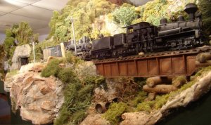

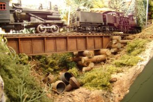

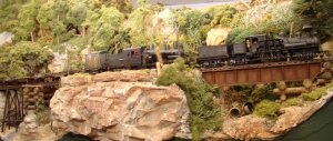

    Bridges Three
    Moving further East on the C&S mainline we come to "Bridges Three". This is were the logging Railroad literally goes up a creek bed to gain altitude. It crosses the creek on three bridges in succession, hence the name "Bridges Three."
    In doing "field research" at the Cass West Virginia living logging railroad museum and riding behind real Shays up in the mountains I learned many things. One of the tidbits of logging RR's is modeled here at Bridges Three.
    Steam locomotives with high "revving engines" like geared locomotives (sounds like its going 80 MPH yet travelling at 5MPH) burn out their smokestacks fairly quickly. The shops were making new ones on a fairly regular basis. The old ones at Cass were thrown down a mountain side. I modeled this on the C&S with a smoke stack graveyard under one of the Bridges three. I have included a picture of the stack graveyard.

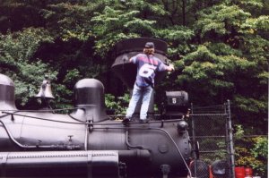

    The screen spark arrestor on the stack of your three truck shay, could not be left covering the stack, at the end of the day. Soot would build up quickly overnight, and would suffocate the fire, requiring a "cold start" the next morning. by loosening the fasteners and providing a bigger opening for the draft, the "fire" would still be able to ignite new coal in the morning, and the loco was more quickly ready for service.
    Here, the Fireman of Cass #5 is clearing the stack, by moving the spark arrestor;

    Hi Sumpter,
    The "science" of running a steam locomotive has always been intriguing to me. I did not know this little piece of steam science. It certainly makes sense. Thank you for passing this on to me. Also I am glad you got a chance to make a pilgrimage to Cass. That is such a wonderful place!!! I have used several ideas I picked up on my one visit to Shay Nirvana on my layout.

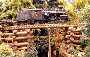

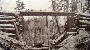

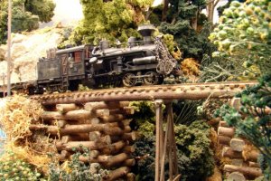

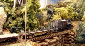

    Hurricane Creek Bridge
    As the C&S mainline continues to gain altitude it jumps over several mountain creeks. Here is the passage over Hurricane Creek on a log crib with one trestle bent for good measure. Included is a prototype picture from which inspiration sprang.
    Doc Tom:p

    :thumb::thumb::thumb::thumb:
    I like the little wood door on the Heisler, and the chain is a nice touch :)
  12. Doctor G
    Doctor G Active Member
    Sep 2, 2008
    1,246
    133
    Thanks ytter_man. I got the idea for the wooden door from a photo of a really decrepit Heisler that "I just had to model."
    I have been hounded by members of my RR club for how large the logging chains are....been told it would break my little HO people's back when they lifted it. But, Hobby Lobby is the only local hobby shop and this is their smallest size chain in the craft section. So..... an attempt at realism was made using those chains.
    Doc Tom:wave:

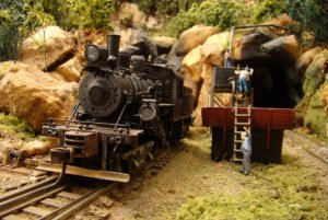

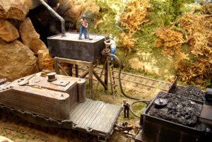

    Thirsty Beasts at Stanleyville Tank.
    After climbing 15 miles of mountainous terrain the geared locomotives are thirsty by the time they reach Stanleyville Tank.
    The crews water down the locomotive and fill the tender with fresh coal for the upcoming slugfest with the rest of the Great Smokey Mountain Range.
    High in the mountains the steam powered skidders and donkey loaders frequently need trucked in water and the crew fills the tank on a flat for the logging equipment.
    Behind the tank and coal bin is the logging spur track leading to camp#4,#5 and #6.
    Notice how old sloped back tenders and an old Shay tank are used to hold and carry water. The Stanleyville Tank is stream fed from the mountain above through a meandering pipe.
    Doc Tom:rolleyes:

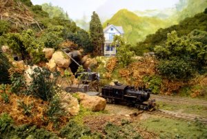

    Whose house is that in the background?

    The House on the Hill
    Hey there MM,
    That is the home of Mr James Joseph. Jimmy Joe is the self appointed mayor of Stanleyville and lives in the grandest structure on a hill outside of town overlooking the town.
    Jimmy Joe made his money by selling land to the Kittom Lumber Company and the C&S RR for logging and placement of the Railroad. The rest of Stanleyville is not doing so well and more pictures will follow.
