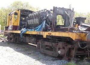

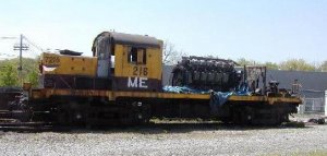

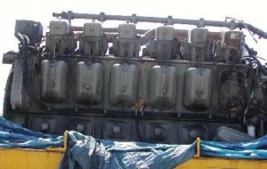

I hadn't seen those photos by Glenn the first time around, very nice. Here are a couple views of an Alco sitting on the Morristown and Erie, being used for spare parts.

Here's Glenn's thread from some time back to give you some ideas.
I had forgotten that I posted those pictures! Thanks Bob.
