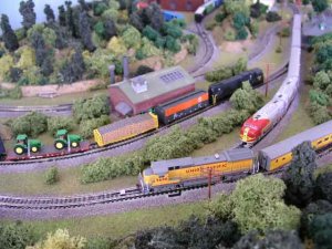

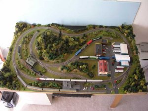

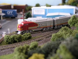

    Latest Pics
    I'm still trying to figure out how to take good pictures of a layout. Lighting seems to be key, and I haven't figured it out yet. I've got to check on this website for some tips to take more effective pictures.
    Here's a total layout shot, sorry for the lack of detail, but it was as much as I could load. This is my first attempt at a layout and I now know that I made several basic mistakes on track layout. I should have completed more research on track design and such before the glue went on the tracks. I needed an operation that would fit my kids abilities (and give dad lots of detail work to do) and this is what I came up with on my own.
    I included a few pics of the Santa Fe FT A/B unit...recently restored and pulling a smooth side passenger consist on a holiday excursion. It met a UP Dash-8 also pulling it's smooth siders on a vacation express.

    While I like the arial shots for giving a great overview of the layout, there's nothing quite like those track-level shots for making our 1:160 models look more like the 1:1 kind!
    :thumb: :cool: :cool: :thumb:
    As for the lighting, it looks like you've got a pretty good handle on it...I'm not going to profess to being an expert on lighting for digital photos, but what I've found works best for me is to have a good light source directly over the subject, & another at the same level, & distance as the camera, pointed at the subject at about 45 degrees to either the left, or right of the camera...
