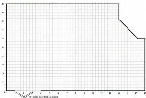

    I had to tear down my layout prior to the summer because we thought we were moving. :cry: Anyway with the crappy economy I guess we're not, considering we didn't have a single showing.
    The good news is I get to build a new layout. Going to take it slow this time as I want to at least build my own turnouts. So here is a measured drawing of the train room. I need help. I would like to model something in the early to mid 50's, mostly early diesel and perhaps a steam engine or two for nostalgia. Most of my equipment is Santa Fe, F3, F7, GP7, GP9's, SW1200, mostly smaller stuff. I do have a good mix of passenger and freight engines/cars. I have done multilayers in the past but not with any great success.
    Any suggestions would be greatly appreciated.

  2. nachoman
    nachoman Guest
    I will second the module recommendation. I'd plan out the whole room in modules, get the shape of the mainline how you want it, then start by building 2-3 of them.
    My reasoning? Sounds like you aren't likely to stay in the same place for more than 5 years. From my experience, 5 years is about how long it takes for me to just get the trackwork and basic scenery done! If you build just a few modules, and then have to move, you can take them with you.
  3. ocalicreek
    ocalicreek Member
    May 4, 2005
    825
    OR, build it as small as you can to include the bare minimum of operation you can live with. If it's going to a be a glorified roundy-roundy (nothing wrong with that) then size is only limited by the longest train you'd want to run. If it's more operations centered then can you be happy with a switching layout?
    Another option is what Iain Rice suggested in a planning mag a while back, to make major sections that can be moved but can be configured in a new setting by adjusting the linking bits between them. Then when you move you don't have to start over, nor are you bound by any limitations modular construction may bring. I'd think sectional vs. modular unless you're into David Barrow's domino construction.
  4. Trainiac77
    Trainiac77 Member
    Jan 5, 2007
    263
    Gentlemen, Thanks for the insight! :thumb: I never thought of doing modules. Actually that makes perfect sense. I think I have a book on module building. I'll Check it out.
    Meanwhile keep the ideas coming!:thumb:

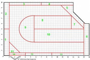

  20. Trainiac77
    Trainiac77 Member
    Jan 5, 2007
    263
    OK so I'm going to go modular. There isn't enough room to use standard modules so I'll use my own design. The picture has some of the basic module shapes that I'm going to build. I will be using 1"x4" pine and 1/2" OSB. I'm still debating over blue foam or just cork on top of the OSB.
    Sections 11 and 14 will be become one unit to be used as a lift or swing bridge. I would like to try to make a double main with some sort of variation so I don't get dizzy watching the trains go round and round and round.:cry:...... I'll have to add some triangles to the corners to make the curves work as well.
    Any suggestions would be much appreciated.
