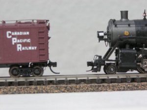

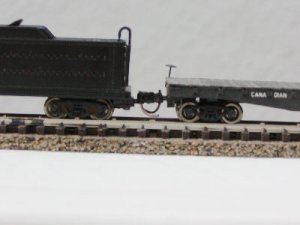

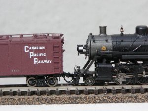

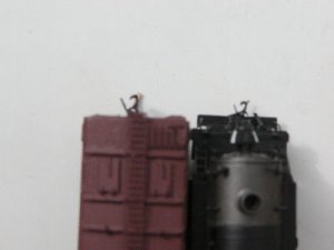

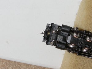

I have converted 2 of my 2-8-0's pilots by removing the non-working coupler from the pilot by pulling it sideways allowing one of the 2 hooks to disengage then pulling it straight out.
I then use a small flat needle file to slowly ream out the coupler hole in order to take a Microtrains assembled 905 Z Gauge coupler.
Have a Microtrains coupler height gauge handy to ensure that the coupler is at the right height and, once the coupler fits snugley into the hole I drill through the pilot platform, tap the hole and screw the coupler in place, trimming that part of the screw that sticks out ot the platform top with a pair of nippers.
I find that the Z Gauge couplers work well with N couplers provided that they are the right height.
Use the MT #2002 for your Mike, as it has everything required for both tender and pilot conversions.

I used the suggested MT 2002 coupler for the Mikado. The packaging it comes in says for pilot conversion and tender but the MT web site says no pilot conversion available. Confusing.
Thanks. Looks and works fine.
Terry (K.V.Div)
Thanks for the photos. I am convinced. Tried 3 different hobby stores but none carry the Z couplers or anything else in Z scale. Now that I have seen what they look like after the conversion, I will place order for Z scale MT#905 couplers.
