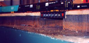

Interesting idea but I don't think there's a way to make Elmer's dry clear despite diluting. I also wonder about shrinkage or cracking when it dries. I like to make water with acrylic gloss medium...a large bottle costs about $16 or so. It requires several applications to make it look deep and "wet" but I like the effect.
Here's a picture cropped to show part of a river on my layout. Not a great pic but maybe it conveys the idea.

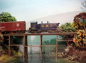

Here's a picture of some water I modeled with the gloss medium...

How thick is that gloss medium, and how may coats did you use on the water in your picture? How about what's under the water, is it painted or a sheet of acrylic or what?

The gloss medium in the picture above was brushed on in about 4 or 5 heavy coats...I'd say it's in the neighborhood of 1/16" thick...this is time consuming, because you have to wait for each coat to dry at least several hours.
To model the stream bed, I poured soupy plaster, to get a smooth surface, After the plaster hsd dried, I painted it flat black, & then dry-brushed the bank areas with Polly Scale Dirt, feathering it toward the middle. The effect is (hopefully) that the bank appears to slope down toward the deeper, middle of the stream.
