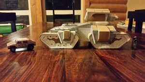

That's some really great advice, Zathros! I'm working on a Siege Tank from Starcraft right now. I'm also building it "vanilla," and going to paint it afterwards. Some of the more detailed parts I've soaked in super glue (super glue GEL does not work for this, by the way) and sanded, but a lot of the interior pieces I've reinforced with balsa and cardboard.
I was actually considering giving the whole thing a coat of lacquer when I found this post.

13,498
9,549
Show us how it works out for you! :)
