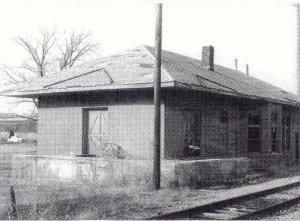

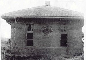

This is the beginning of the old Kosmosdale depot. The old structure is located in Louisville Ky. The building is starting to fall down. However it is on the endangered species list in Jefferson county archive. So far no funding for restoration. The structure serviced the Illinois Central for many years. I will post the plans if anyone is interested in modeling this old structure
philip :(

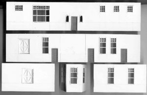

walls, windows, and doors
WW&D... HO scale

north side
Northside with IC logo

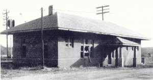

track side
Notice the water diverters on the roof over the freight doors

Everybody: Glad your interested. Its a shame without funding this structure will be on the ground soon . The roof has been leaking for 10 years and people have vandalized the old depot! The pictures posted are 15 to 20 years old. Its a dang shame. Paducah and Louisville run the old tracks that spur off to Louisville Gas and Electric Company. Kosmosdale was a small town in Southwest Jefferson County. Kosmos Company made concrete and brick mortar here since around 1900. The depot is next door to the cement plant....no one cares, looks like the concrete company and LG & E would fund the fix up. I'm sure the CSX company would donate the property. CSX bought up P & L at least part of it.

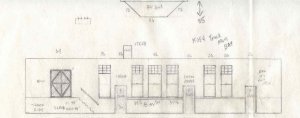

philip
track side 66 ft not including overhang
Its amazing. Normally the roofs over bay windows usually have a gable or hipoff both sides!

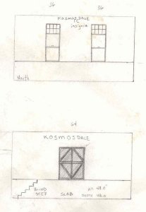

two end panels
width 26 ft.

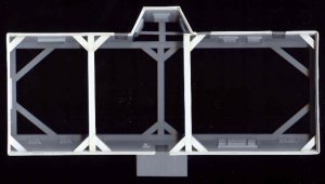

walls up/ windows trimmed/portico started

non- finished interior
Back to work!:)

materials
Matt, Everthing is made from evergreen plastic except the entry 5 panel Grandt Line doors. I'm no expert at this scratchbuilding stuff. I was going to use Grandt Line windows and then add the transon on top ..when I did a few and tested for fit the windows were to tall into the soffit/bead board overhang. :( The windows have been a thorn in my side but finally its coming together. Another big problem was the bay window...you see the overhang was 5ft ..had to cut the bay down to 3 & 1/2. Just wasn't enough clearance on the portico side. Different reveals/margins on the overhang just looks horrible..anyhow its on the bench ..still trying to get the rise, run, and rake together. That white plastic makes it look like a White Castle Hamburger stand or the old art deco Gulf Station LOL.
