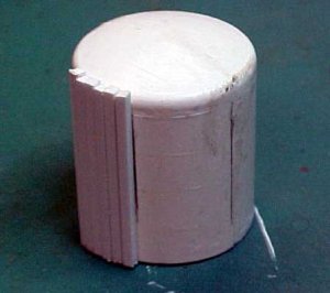

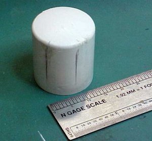

    I used a square to draw some vertical guidelines on the tank, & then glued some 080x080 Evergreen styrene strip to the sides

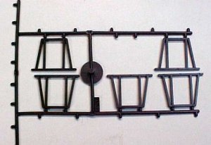

    To make a support structure for the tank, I found some HO trestle bents in a Walthers O.L. King & Son Coal Co...

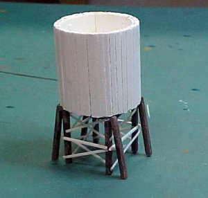

    I trimmed up a couple of the bents, & added some styrene strip for bracing...

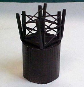

    I primed everything with Floquil Roof Brown...

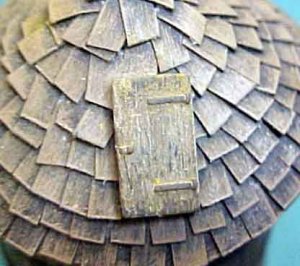

    After a botched attempt at making shingles from construction paper, I went back, sanded most of the flat black paint off the roof, & started making shingles out of strip styrene...

    I got some detailing done last night...
    I added a roof hatch...
