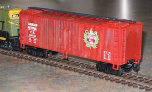

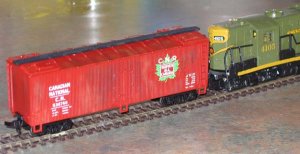

    Here are a couple pics of my recently painted CN box car, which previously had cartoon graphics and ads all over it. This was a box car from a Loblaws Presidents Choice set. Each year Loblaws (grocery store chain) sells an IHC Christmas train set -- while the locos are good the freight cars are often covered with Loblaws ads.
    At any rate, I spray painted it with some brown/red Tamiya paint (not 100% accurate but close). Then I applied some CN decals and then I weathered it with some rush and grey chalk, also made by Tamiya.
    I'm curious to hear your comments and feedback. Please note that, while I've done spray painting and decals before, this was my first weathering attempt! :mrgreen:
    I included the diesel just for effect. It's also a kitbashed/repainted GP9.
    Thanks in advance.
    Rob

    I'd say you did a nice job. Any chance you have a before and after picture? As for some feedback on the weathering (and I'm by no means an expert) You could add some rust colored chalk to the trucks, couplers, and wheel sets depending on how weathered a look you're shooting for. Also, you could use a downward stroke from the CN lettering in white chalk to give the impression of rain washing away and running the white lettering down. A touch of rust on the door hinges, ladders and hatches might work too. Naturally, the front and end of the car would be dirtier from road grime and from the rain runoff from the other cars in the train - assuming this car is used frequently. Also, a little white chalk all over the roof will give the impression of sun damage and fading to that red paint. I'm partial to using chalks since I've got no talent for using dry-brush paints or alcohol wipes (as my first and embarrassing weathering photos a few years ago proved). Plus with chalks, if you don't like the result - you can rub it off and try again!
    Great job and that diesel looks really nice!

    A little light paint on the trucks would be nice.
    Car ends often have a bit of dirt kicked up by the wheels on the car ahead of them -- two thin cones centered over the tracks.

    Nice work on that car, Robert, which, by the way, is a reefer. Here's a link to some weathering tips that I find useful:
    Some simple tips...
    and you can find many other ideas in the Weathering Forum here on the Gauge.

    Actually, I wondered if I had correctly applied the CN decals to the reefer, as the diagram that came with the decal set seemed to show another type of car.
    I'll check out those weathering links as well -- thanks!

    Looks nice. I'd recommend some heavier weathering to the roof, trying to make the logo look faded, and a coat of dullcoat/flat finish.
    The dullcoat is actually the single best thing you can do when weathering...shiny model railroad items are very common, but shiny things of very rare in the real world. But beware...it will soften the weathering of the chalk you've already used.
    Since it looks like a steam era car, some black cinders on the roof would be in order.
    You're off to an excellent start! Perhaps the updated picture might include your OO scale 0-6-0 pushing it :mrgreen:
