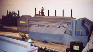

I've built some structures to accompany the blast furnaces I posted pics of last year. Here's the Kings Port Steel company, makers of sheet steel and tubular steel products.
Ralph

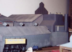

The rolling mills are made of cardboard and are covered with corrugated craft paper.

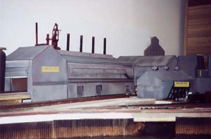

The right part of this mill with the angular lines and smoke stack was originally a broken hand-held seed spreader. I was going to throw it out but it looked so ......industrial! :) The roof vents to the left are cola bottle caps.
