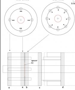

    I'm not totally finished with the arms, but what I did at the shoulder area on the body was to make a series of holes in the former and on the shoulder area of the arm is a series of pegs, the arm is slid out on it's axle, rotated into position and then slid back in lining up the pegs with the holes. This was the easiest concept I could come up with to make it pose-able but give it support.

    Not a bad idea. :) I'll probably be modding it with 360* rotation in the joints, but for the regular modeler that's a great solution to poseability.

    Hey I'm open to suggestions, making the arm rotate up and down at the shoulder is easy, the problem is keeping it in place. I think I figured this system gives at least 8 positions back and forth, I still have to work on the arms so I'm sure about how they will move yet.
