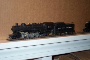

I have this old John English 2-8-2, can anyone tell Me if this is the right tender that would have come with it? It's a one peice brass casting, with no rivit detail. I bought this as a basket-case at a show and the tender came with it. I hear that In the early days of Ho you bought the locomotive and tender seperately. Could that be the case with these?

I found most of these at shows as basket-cases. Then searched high and low for the parts to complete them. Some parts need to be substituted or built from scratch. What other oldies would you like to see?
pjb
Dec 21, 2000
The tender is not the original tender offered with this loco. English's pacific and mikado shared same boilers and tenders and were made out of diecast zamac . They were cheapest kits of such 'large power' when introduced , and if anything had too large rivethead detailing. Bowser (NYC 'K-11') , Penn Line ('K-4' & 'L-1') also produced didcast locos , but charged more and included the valve gear. Mantua sold loco that was loosely based on Reading prototype which was made of cast zamac and fabricated brass . Varney was closing out there production of mostly cast bronze boilered steam locos , that had originally been sold in kit portions , and as economy kits , and premium kits. This complex setup went back to the Great Depression when no one, "had a penny to jingle on a tombstone" -much less buy model rialroad kits.
Shortly after this ('50-'51), Varney began pushing diesels and added a single SP based 4-6-0 marketed as the "Casey Jones". Mantua went to diecast metal, and knocked out the generic modern pacific and mikado using the same interchangeability English used.
MDC was to start making something larger than 0-6-0s shortly before the combination of Slot Car racing , Japanese imports, and other toys kicked 'HO' scale trains in the headin the early '60s. Varney folded its tent around the time of Gordon Varney's death, and the English firm went an acquired Penn-Line, John English , and the Bowser line of steam kits. They also picked up Selley and Cal-Scale's line of detailing components and kits , and eventuall Varney's diecast threesome of: "the Dockside" (B&O 0-4-0T of collosal proportions); "Casey Jones" (SP looking 4-6-0); and "Old Woman" (SP/Harriman looking 2-8-0).
In any event, your loco has the separate valve gear kit applied (2 to 3 bucks) and does not have the original tender. John English ( which is not same company as own hobby shop and all the loco marques just mentioned under BOWSER name ) also made a Pennsy 0-4-0 (diecast zamac marketed as the "Yard Bird" and an industrial diesel similar to Lindsay's model . John English also seems to have owned or been involved with company marketing self-propelled electric cars under the Pitman label. Pitman motors is part of conglomerate we know up there in NE Pennsylvania as Bowser. The Pittman electric MUs used same bodies as John English's diecast passenger cars.
If you have solid brass tender that is like nothing I know of. There were many fabricated brass tenders, and Varney had several hollow cast brass or bronze tenders, in their early line up (1938-1950). I hope this helps.

This is great information. Thanks for sharing it.
The search is on for the correct tender. The one I've got here is a hollow casting as you mentioned.
Once again, thank you for that bit of HO history . It's not that easy to come by.

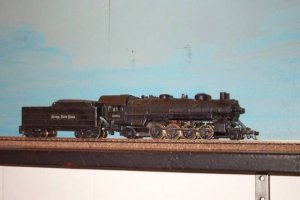

I have a one peice zamak tender behind a kit-bashed mikado. I got it with a bunch of OLD Mantua parts. I assumed it was an old Mantua. Not sure.

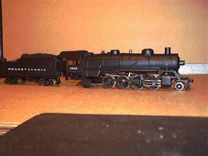

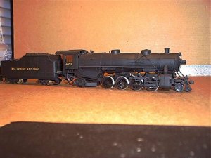

The tender in your picture did not come with the engine originally. I have two of these engines and one has the original tender which is a metal casting and has lots of rivets. The second engines tender was damaged beyond repair, so I am using a Bowser tender. Note the Pennsy tender on the second engine. The pilot on the upper engine is a scratch built brass built from a magazine article. Joe

The tender on your kitbashed Mike (nice work) looks to me like it could be a Varney. I have a 1953 Varney catalogue that shows a very similar tender....they call it a "Diecast Dilly" and label it a "Varney value at $4.00".
