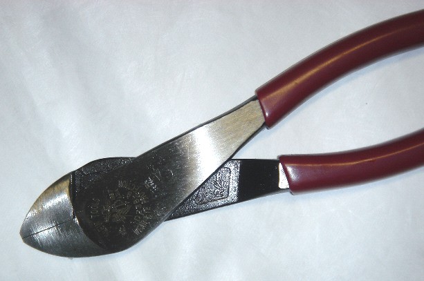

Btw, I am not pretty sure what a flush cutting wire cutter looks like. Is this it: http://www.msrachel.com/thejewelryworkshop/shop/photosshoppage/German flush cutter 800K.jpg
or like this:
http://www.bunnyrabbit.com/equipmentpix/flushcutterKlein.jpg
And what is the difference between an ordinary wire cutter and a flush cutting wire cutter?
Those are one form of wire cutters. The ones that we're talking about are shown on this site here. There are several other discussion on the Gauge about using these cutters on flex track.

The normal wire cutting pliers have a V shaped blade and leave a projection on the end of the rail. Flush cutters cut one side of the rail almost even (still need a bit of filing) and a bigger mess on the other side.
Thanks for the replies. :) I did a few experiments on some portions of expendable flex track. My flex track brand is Peco. I tried the hack saw, and it was difficult. And then I tried a small wire cutter, and it was difficult. I tried a big wire cutter, and boy, it was lovely easy! The only problem with the big wire cutter is that I think it's not a flush cutter. It made the edge of the track form a letter V. I guess I'll go for a big flush cutter. :)
