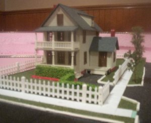

Here's some pictures of the houses almost ready for their new home.
