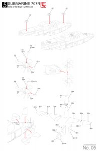

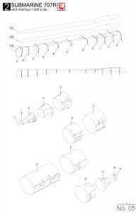

  1. goodduck
    goodduck Active Member
    Jul 26, 2010
    540
    268

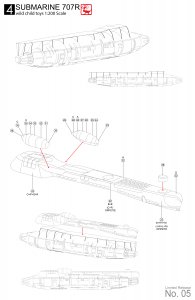

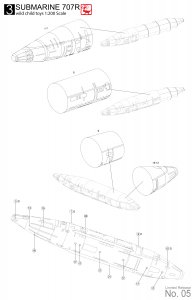

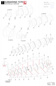

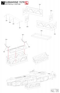

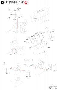

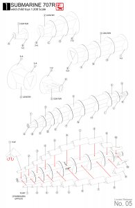

    My Submarine 707R instructions are done. Think that’s doable? ....... I really really really.... really don't like to do instructions....... really don't like to ......it makes me sad, really sad knowing I have to do instructions....... maybe that's why I never finish anything.........
    lyter1958 and Rhaven Blaack like this.
  2. Rhaven Blaack
    Rhaven Blaack ADMINISTRATOR Administrator Moderator
    7,733
    2,683
    I know that instructions are a problem for any model (at any skill level)
    You have done a GREAT JOB on the instructions.

    Thank you. I just noticed I forgot couple of thing need to add.
  4. goodduck
    Jul 26, 2010
    540
    268
    Added the lines types and fixed the typo. That should do it. Next is test build version …. #3
    Rhaven Blaack likes this.
  5. goodduck
    Jul 26, 2010
    540
    268

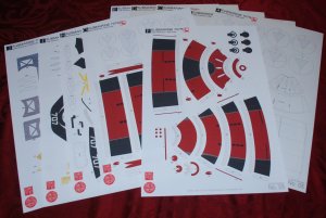

    The test print looks pretty good, can’t wait to build some paper again. Hope this is the final test – crossing my figures. Because it is for test build, I didn’t bother to print out the cover and instructions. But this is how my 707R kit will come in when it is ready. 10 sheets of 13”x19”, including a 13” x19” cover sheet and 7 11”x17” instructions sheets. The kit will be package in clear flap seal bag and backing board to ship to...... everywhere.

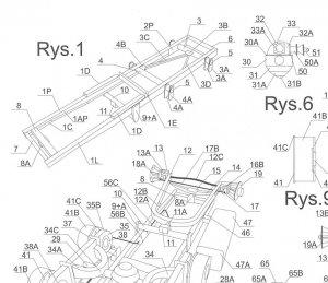

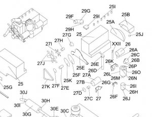

  16. Gandolf50
    Gandolf50 Researcher of obscure between war vehicles... Moderator
    Jan 28, 2013
    553
    572
    I agree with Zathros..simple ask questions! Research! As far as instructions..I do like exploded views the on tricky areas a more detailed exploded view or from alternate angles...Angraf- GPM are well done..it is easy to follow Modelik on the other hand fall short in that the have isometric views and don't explain or explode the view they are hard to follow..just my opinion..
    Angraf.jpg Angraf Example Easy to Follow
    GPM.jpg GPM Example Easy to Follow
    Wak.jpg Wak...Pain in the A** and instructions say "follow picture 1 and put parts together"! as in my current build...Wak-2013-02 - Scammel Pioneer SV-2S...Really GOOD model..but has many faults that were not corrected after the test build...and instructions!! Ackkkkk

  18. Zubie
    Zubie New Member
    Jan 22, 2015
    30
    14
    You can see in the lower left step of the WAK how the 3D non-exploded view can start to break down as the number of parts involved increase creating a crowd of part numbers and indicator lines. Also given that it isn't exploded it might be hard to see where one part ends and the other starts. I really like how the GPM instructions are exploded to show the individual part assemblies, but the image of the assembled engine right next to it as a reference is very helpful. Also another little detail on the GPM the part numbers are related, for instance the engine block parts are 25* and the fan belt stuff 27*. Again, one of those things one might not think about, part labels, but what and how you label can help too.

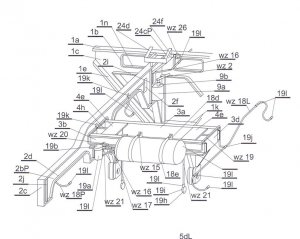

  19. zathros
    zathros -----SENIOR---- Administrator Moderator
    8,458
    4,116
    On my models, I actually label the parts themselves, not the finished parts, but the interior. The last picture shows where each part connects to the rst. This was a rough draft. I had not yet removed the superfluous dots.
    [​IMG]
    [​IMG] [​IMG]

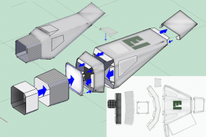

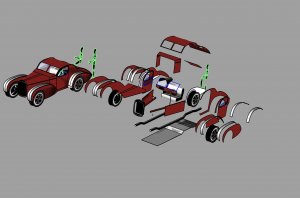

  20. Zubie
    Zubie New Member
    Jan 22, 2015
    30

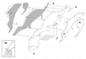

    14
    Based on the discussion on the thread, here's a pic I'm working up on a design I'm finishing up. I've built the model, I just need to finish up the instructions and number the parts.
