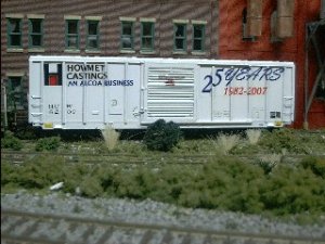

I've tried the Testors paper(in fact, check out the article in the last issue of the E-Mag...link at the top). Its OK. The best I've found is the Vita-Cal decal paper.
I'm always making my own decals.
Here's my lastest..I did for my companies 25th Anniversary.

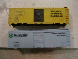

Here's a couple I just did, still need dullcote to blend in the decal edges and then some weathering.
It is pretty fun doing these things, since mine RR will be freelanced, I can come up with railroads that never existed. If you haven't tried it, you should.
