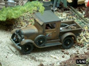

When I have my camera set up on 'macro', with 'aperature priority', then zoom right in, and it is on 'auto focus'. How can I tell what it is actually focusing on?
This shot was supposed to be focused on the truck.

Nice shot Drew!
I really like all the clutter, & junk laying around...the stuff in the bed of the truck looks exactly like what's in the back of the one out in my driveway!!:D
It looks like maybe they've had a flat tire, & have the right front jacked up to change it...:)

Hi Drew, No need to use Macro & Zoom together, zoom will overdride the Macro setting with what ever it looks at. Macro is really used for closeup work say (3" - 10") even so, depth of field will not be brilliant. Zoom isn't used much in Model Photography due to less depth of field than ever.
It is the f-stop that makes a difference to depth of field. I have my Digital set on f8 and 30th second shutter and on a tripod. You can get away with just using Aperture priority letting the shutter take care of itself but it would still need to be on a tripod. Use as much light as possible also.
Shamus

Thanks to all for the reply, sorry for the late reply. Just got in tonight from work and thought I better write back!
Shamus- OK, I won't use macro and zoom at the same time:eek: :eek: But when I do zoom in a bit to fill the frame better, the fstop # does increase automatically to about f4, then I can bump it up to f16 manually, which I try to do on all shots.
Vic- thats the problem, when I switch to manual focus, there doesn't seem to be a very acurate way to focus. It is kind of erratic, in and out of focus. I think I'll leave it on auto.
Satokuma- the truck is a Jordan kit, and it is the fourth one I've done now. The detail is very good, and delicate!! It is very hard to drybrush and apply weathering because the detail is so small. You really have to be carful when your holding it too, or you can brake a rear tire right off!!
kettlestack- the Jordan bus is next!! and oh yea, the manual ... now where did I put that:rolleyes: :rolleyes:
Charlie- that is the first thing my wife said, "look, the one tire is off the ground". Come on, it's not like they have a 'working' suspension system!!
Jon- and you mentioned the documentation as well:eek: :eek: OK, I get the point!!
Santa brought the AC adapter for the camera, so I should just set it up now, and snap away. I can try all the variables to try to figure out, how to get the better shots.
OK Shamus, I've summed it up this way,
lots of light
use a tripod and remote
highest aperature setting
least amount of zoom.
sound about right?:) :)
Drew
