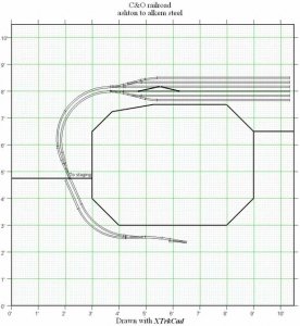

    OK guys,here how far i have goten.it isnt much but i still cant find a way to keep my 5ft minimum yard length wall1.this is a weird angle to work with also so any help is appreciated :mrgreen: .TIA.--josh

    sorry about the HUGE pic,but im having trouble with photo bucket :D --josh

    Josh, I Like the Staging Tracks.
    I might suggest adding 2 lefts and 2 right hand switchs to connect the middle 2 tracks (3rd and 4th down).
    This is what I would do:

    thanks for helpin josh,but ill still need a way to turn the whole train or atleast the engine,cause steam rarely ran backwards on a mainline.i was thinking of building a turntable under it but it could be hard to check the alignment of the tracks under 8in of space.--josh

    OHH, I got it now lol, i forgot you were doing Steam.
    Okay so, You want a train to come from the main level down to staging and then have it leave the yard and return to the main level rite?
    And that is why you have that "dead end" track for rite next to the one that is already going down to staging?
    I think I might be able to help, just getting the facts straight lol

    What is the radius of the curve you have on the staging level? Could you go any smaller then that?

    my minimum radius for hidden track like this is 20in but for my 2-6-6-2 id like to keep it around 22in.and this is hot it goes,that dead end track is seperate it is for the depot.the engine will leave the mainline to go to a "destination"then return heading the opposite direction,not backing out of the yard.i hope im not confusing anyone with my un-edumacated lingo :D --josh

    Well there goes what I had in mind lmao :oops: I had smaller radius lol
    Sorry I couldn't be more of a help, im sure someone can figure it out :mrgreen: :thumb:

    h well,looks like im back to the drawin board :D thanks though --josh
