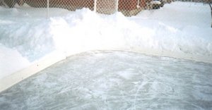

Mike, you don't say what kind of rink you're thinking of, whether a hockey rink with boards and markings, or just a pleasure skating rink.
I found this image with a Google search and it has some pretty good details as to the colour of the ice and the typical marks left by skaters.
A higher end hockey rink will typically be re-flooded more often than a pleasure skating rink, after which it will not have scratches.
It seems to me if you use clear acetate, or plexiglass, you could paint the subsurface a light bluish grey, then scratch up the surface to simulate skate marks. Good luck and keep us posted if you decide to try it.
