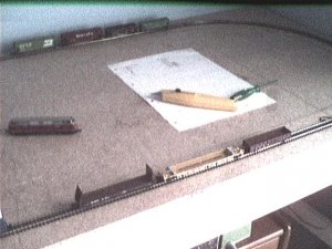

    this is what I'm talking about:
    notice
    one Union Pacific ballast hopper
    one ATSF ballast hopper
    one Santa Fe covered hopper
    one Burlington Northern Covered Hopper

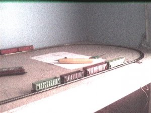

    and this!

    thats fine they all run together on the same train and its your railroad and you run it the way you what it and down the road when you have 100 or so coal cars then you can have a coal drag but most of the time there all mixed up :D rich
