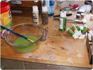

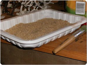

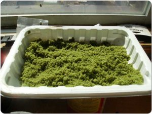

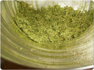

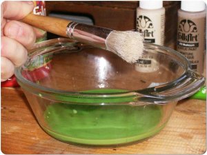

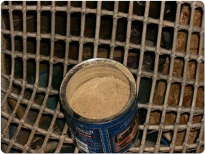

Ok I have seen the question many times and wanted to prove something to myself and now you.
Ok this isn't a question it is an answer. Ok we made the ground cover with Sawdust. We used acrylic and water and a coffee can. Detailed instructions in the link. however for those that don't want to go it is terribly easy and I could not seem to screw it up.
Full article here

This may be a throwback to the earlier days of model railroading, but the colour and texture definitely shows it to be a step forward. A very useful and money-saving technique. :thumb::thumb:

I've got a bunch of sawdust that I dyed a long time ago using Ritz powdered dye. It didn't turn out nearly as good as what you've done. The colors I came up with didn't look natural, yours do. I really like your idea using watered-down acrylic paint.
A great tip.:thumb: :thumb:
Oh, you've convinced me to throw away all that old stuff that I have been hesitating to use, and try it your way.:wave: :wave:
That's definitely a return to the old school. For that matter, from the 1920s through probably the 1950s, Lionel used to sell dyed sawdust as ground cover, but it didn't look like that (when they were going for realism, Lionel's layout builders used something else).
The sawdust you made looks really, really good.
