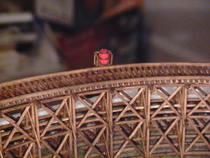

For materials, I recommend using basswood. It's a bit more sturdier than balsa wood, but soft enough to work with easily. It also looks good painted or stained.
As for tricks and tips, I highly recommend you build a jig. It's a bit more work up front, but it will ensure that all your "bents" are the same and line up nicely.
Check out this link for some information:
http://www.blackbearcc.com/why_use_jigs.htm
While you could go out and purchase one, it's quite easy to make your own.
Another suggestion would be to avoid the following: curves and inclines! While both possible, it adds another level of difficulty that I had to learn the hardway!
Here's a picture of the one I did. Hope this helps!
