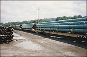

These pipe loads. Which evergreen/plastruct tube is correct size, and what is best paint to match? As for the TTZX cars, anybody have these in N, and what is a minimum radius for em?
I've seen a color close to that at the hobby store, I would just get the color that looks close. Try this link for flat cars. http://www.alancurtismodels.com/
Screwy squirrel is right I have used the tiny straws for stirring coffee yea that's it coffee,that's were they came from. I then took sewing thread and wrapped them and or thin pin stripping tape to simulate metal banding. Pat
if you are not caring of scale size then I would use toothpics, cut the pointed ends off and paint. If you do care about scale size then go to the hobby store train or other and get some hollow steel tubing and paint. good luck
Joe in Houston
I primed mine with a spray can and then brush painted over that with black pollyscale and have had no trouble with them. One thing I would recomend is to insert something straight and solid inside one of the middle straws slightly shorter so you dont see it to help keep them straight and true . Pat
