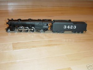

Any suggestions on which brand of decoder with sound will work the best with my MRC Prodigy Advance DCC system? How expensive are the decoders with sound? this will be my first install so I am a little nervious. Also I heard something about Rivarossi locomotives having a history of poor power pickup and wonder if I should bother equipping this one for my layout...any input on this issue?
