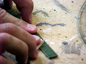

...so I trimmed it lengthwise, & about a foot or so off the height.
Then I used a piece of sandpaper to rough it up a little.

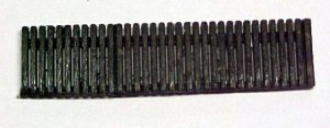

After that, I brushed on a very thin wash of Floquil Engine Black.

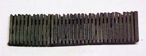

Next, I dry-brushed with Polly Scale, RR Tie Brown, Dirt, & Aged White (in that order)
I also used a small file to "break" some of the boards at the top of the fence.
