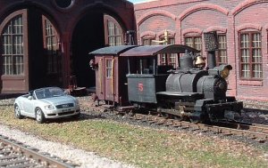

  6. nachoman
    nachoman Guest
    hey, Bob - that saddle tanker looks great! Any info on how that came together?
    kevin

    Thanks everyone- this thread generated so many good ideas in a really short period of time (not only great answers to my question, but inspiring modelling from Shaygetz, a link to bnfhobby- can't believe I haven't run across that yet, etc.) You all have been really helpful and has given me a lot to think about. I'm going to ponder this a bit more, and will post some pictures once some rolling stock finally starts moving along the RQCRR. Thanks a lot! (and the Gauge rules!)
